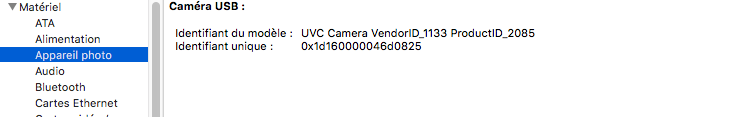

- Webcam + micro OK

- Logitech HD Webcam C270
